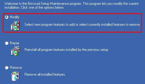

  1. Run the Bricscad Pro installer (or the installer from a Bricscad CD).
  2. Select the Modify option.

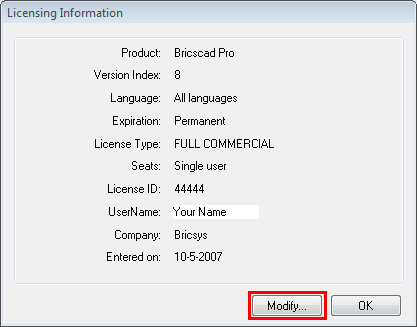

  3. In the Licensing Information dialog box, click the Modify... button.

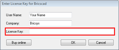

  1. Enter the new Pro licence key  in the License Key field to replace the already installed Classic license key.
    If the licence key was sent to you by mail, it is recommended to copy/paste the key from the email message into the License Key field.

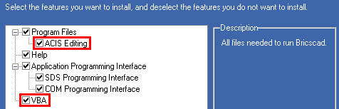

  3. Select the Pro features: ACIS Editing and VBA .
These features are only selected if a Pro licence key was previously installed.
Do not unselect other (installed) features : unselect a feature means uninstall it !
