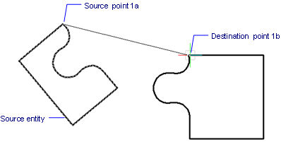

To move entities, specify one pair of source and destination points to move entities:
| Option | Description |
| Specifies the source alignment point, such as #1a in the figure above. | |
| Specifies the destination alignment point, such as #1b in the figure. |
To move and rotate entities, specify a second pair of source and destination points to move and rotate entities:
 | Specifies the second source alignment point, such as #2a in the figure above. If you press Enter at this prompt, the source object moves. |
| Specifies the matching destination point, such as #2b in the figure. |
