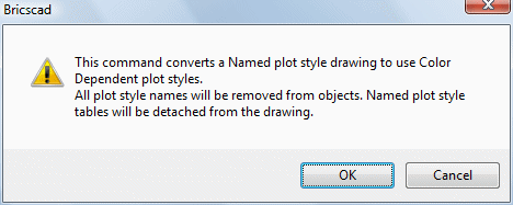

To convert a drawing from STB to CTB file type
  1. Type convertpstyles at the command prompt, then press Enter.
    An alert box displays:
  2. Click the OK button.
    The drawing is converted.
