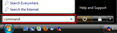

On a 32 bit Windows Vista or Windows 7 system do the following:
  1. Click the Start button ()on the left hand side of the Windows task bar.
  2. Type command in the Windows Start Search field, then press Enter.
The Administrator Command Prompt window opens.
  1. Type bcdedit /set increasuserva 3072 in the Administrator Command Prompt window, then press Enter.
The memory limit is increased to 3GB.
  1. Close the Administrator Command Prompt window.
