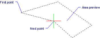

Entity/Add/Subtract/<First point>: (Pick a point, or enter an option.)
As you pick points, Bricscad previews the area with a dashed polygon.
Use entity snap modes to ensure your picks are accurate.
When done picking points, press Enter; Bricscad reports the area and perimeter like this:
Area = 6.1836 sq. units, Perimeter = 11.2968
