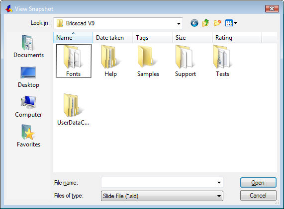

Displays images saved as SLD or WMF files (short for "view slide").
WMF files are not supported on the Linux platform.
command bar: vslide
aliases: vs, vsnapshot
menu bar: Tools | View Snapshot
toolbar: Tools | ![]()
: vslide
Choose a file, and then click Open.
To remove the slide from the viewport, use the Redraw command.
Specifies the name of the slide file. |
Selects the file type of the slide file:
Displays the slide in the current viewport. Use the Redraw command to remove the slide. |
MSlide - saves drawings in SLD, EMF, and WMF formats.
Redraw - removes the slide from the viewport.
