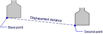

Enter Base Point
Specifies the point from which to copy.
Use entity snaps to pick the starting point accurately.

Enter Second Point
Specifies the destination of the copied entities.
Hold down the Shift key to copy entities horizontally or vertically.
You can use x,y,z coordinates to copy objects in 3D space.
ENTER to Use Base Point As Displacement
Determines the displacement distance from the coordinates of the base point.
