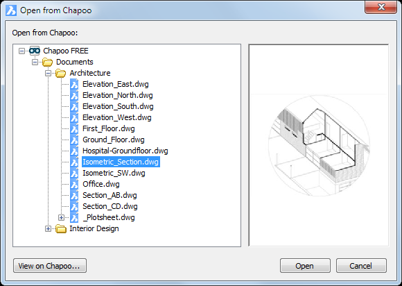

Downloads and opens a drawing from Chapoo.
command bar:  chapooopen
menu bar:  File | Chapoo | Open...
: command
If you are not yet logged on to Chapoo, the ChapooLogon command is launched first.
View on Chapoo...
If necessary, prompts you to logon to My.Chapoo.com, then shows the drawing in the Chapoo viewer.
Open
Downloads and opens the selected drawing.
A temporary copy of the drawing is saved in the folder which is defined in the ChapooTempFolder user preference (e.g. C:\Users\<UserName>\AppData\Local\Temp\).
When saving the drawing, a dialog displays:
  • Upload: Uploads the drawing to Chapoo as a revision of the original drawing.

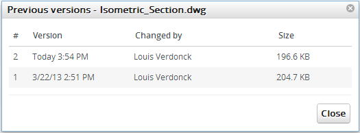

    On Chapoo the Previous Versions icon () displays when hovering over a drawing of which revisions have been uploaded.
    Click the Previous Versions icon () to see a list of all available revisions:
