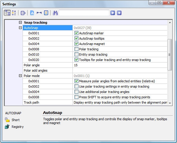

Displays the Snap Tracking section of the Settings dialog box:
Change settings, and then click X.
AutoSnap
Specifies the look and action of AutoSnap:
  • AutoSnap Marker - toggle the display of the AutoSnap marker, which indicates the type of entity snap; default = on.
  • AutoSnap Tooltips -  toggle the display of tooltips adjacent to the entity snap location; default = on.
  • AutoSnap Magnet - toggle whether AutoSnap jumps to the nearest entity snap geometry; default = on.
  • Polar Tracking - toggle polar tracking, where BricsCAD shows polar angles; default = off.
  • Entity Snap Tracking - toggle entity snap tracking; default = off
  • Tooltips for Polar Tracking and Entity Snap Tracking - toggle the display of tooltips; default = off.
Polar Angle
Specifies the default polar snap increment; default =15 degrees.
Polar Add Angles
Specifies additional user-defined angles for polar snap.
Polar Mode
Specifies how polar mode is handled:
  • Measure polar angles from selected entities (relative); default.
  • Use polar tracking settings in entity snap tracking.
  • Use additional polar tracking angles.
  • Press Shift to acquire entity snap tracking points.
Track Path
Determines how the tracking path is displayed:
  • Display full-screen entity snap tracking path.
  • Display entity snap path only between the alignment path and the From point to the cursor location; default.
  • Do not display polar tracking path.
  • Do not display polar or entity snap tracking paths.
