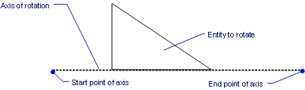

Specifies the start point of the axis of rotation. |
Specifies the endpoint of the axis of rotation. |
Uses the geometry of an entity as the axis for rotating the entities; prompts you: Select an arc, circle, ellipse, line, 2D or 3D polyline segment - specify the entity. BricsCAD determines the axis of rotation from the entity:
