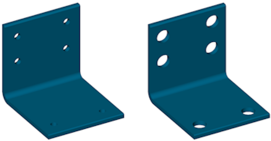

Direct modeling operations allow to change geometry of 3D solid models easily: when a single face of a solid is modified with a particular operation other faces are modified accordingly in order to keep design intent of the model and its topological and geometrical validity. For example, consider a model with a number of holes of the same radius. When the radius of a cylindrical face is modified with a push/pull operation or by changing the value of a radial constraint other faces that share the same diameter are recognized by BricsCAD and modified automatically to keep the radii synchronized.

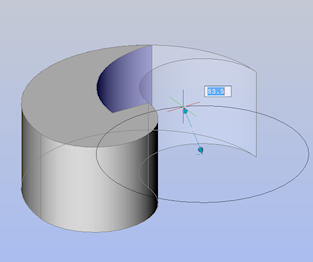

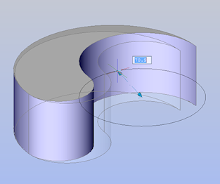

tangent surfaces (planes, cylinders and
cones) ()

surfaces of equal radius (cylinders and
spheres) ()

tangent surfaces recognized ( |
tangent surfaces not recognized ( |

equal
radius recognized ( |
equal
radius not recognized ( |
