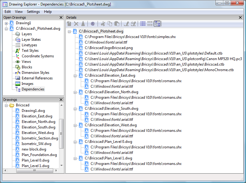

Choose Drawing Explorer > Dependencies... in the Tools menu.
Type etransmit in the command bar, then press Enter.
The Drawing Explorer dialog opens the Dependencies category is selected:
Click the eTransmit
button (
) in the Details toolbar.

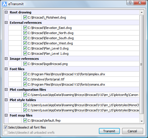

The eTransmit dialog
opens:
By default all dependencies are selected to be
included in eTransmit.
Click a checkbox to remove a file. Click again to add a file.
Click the Transmit
button.

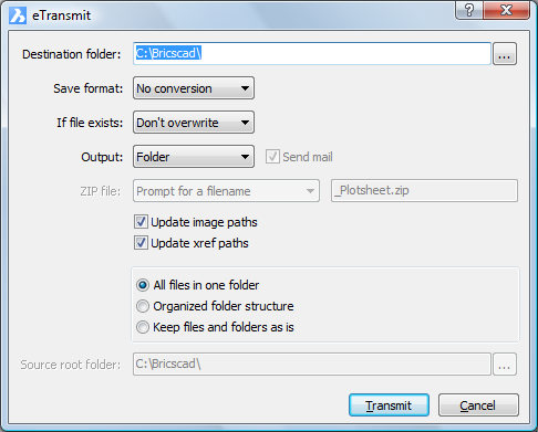

The eTransmit settings dialog
opens:
Click the Browse for
folder button (
) to select the eTransmit
destination folder.

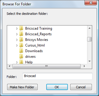

The Browse for folder dialog
opens:
Select the eTransmit destination folder, then click the OK button.
Define the eTransmit settings:
Save Format: Optionally, choose a different DWG version. All drawing files in the eTransmit package will then be converted to the selected format.
If file exists: If a file exists in the output folder, you can choose to overwrite it or not. Choose Abort if you want to exit eTransmit in such case.
Output: Choose whether eTransmit creates a ZIP file or not.
Send mail: This option is
available if Zip file is chosen as
the Output option only.
If checked, eTransmit prepares an email, with the ZIP file in
attachment.
Zip file: Choose an option to name the ZIP file.
Update image paths: If checked, the saved paths for image files are updated, according to the new location.
Update xrefs paths: If checked, the saved paths for xrefs are updated, according to the new location.
Folder structure: If the source files exist in different folders, select an option.
Click the Transmit
button.

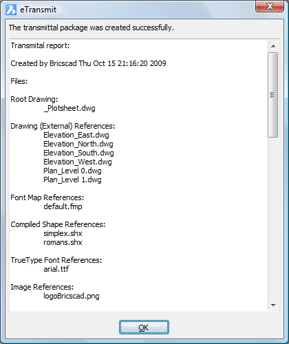

The eTransmit report window displays.
Click the OK button to close the
report window.

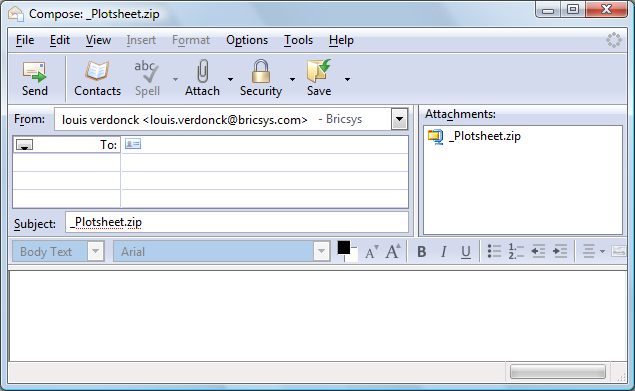

If the Send mail
option is chosen in step 7, eTransmit creates a new mail message
with the ZIP file in attachment.
