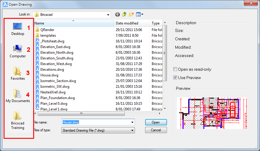

On the Windows platform: the fifth folder in the Open File dialog's Places bar.
PlacesBarFolder1 - 4
First, Second, Third and Fourth  folder
Sets the folders 1 through 4 in the Places bar of the non-standard Open File dialog (Windows platform only). Values between 0 and 5 are accepted: 0=Desktop, 1=My Computer, 2= My Documents, 3= Favorites, 4=Network, 5=My Recent Documents.
