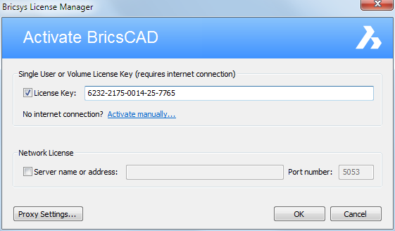

Some computers connect to a network or the internet through a proxy server. Therefore the proxy settings should be configured before activating or deactivating a license.

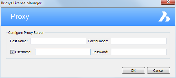

In the Activate Bricsys or the License Information dialog, click the Proxy Settings... button.
The Proxy dialog opens.
In the Proxy dialog, fill out the necessary fields.
Click the OK button to continue.
