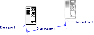

Enter base point: <Displacement> (Pick a point, enter x,y coordinates, or type D.)
Enter second point: <ENTER to use base point as displacement> (Pick another point, or press Enter.)

Enter second point
Specifies the destination for the entities.
Pick a point in the drawing, or enter x,y coordinates.
Displacement
Specifies the distance to move the entities; prompts you:
