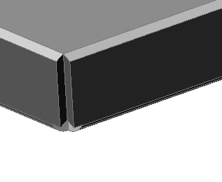

 Closes gaps between two arbitrarily oriented flanges.

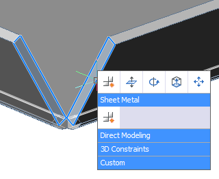

Select planar thickness faces of two flanges: (Select the face on the first flange.)
Entities/subentities in set: 1
The flanges are connected.
If SELECTIONPREVIEW is 2 or 3, thickness faces of flanges highlight. Press the TAB key to select obscured faces.
Quad cursor menu
Select the planar thickness faces of two flanges, then choose Connect Flanges () in the Sheet Metal command group.
