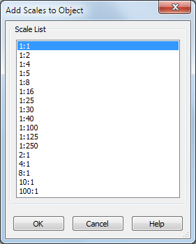

Add
Adds annotation scales to the selected annotative entities.
Select one or more scales in the list, then press the OK button to add the selected scales.
Press and hold the Ctrl key to:
  • select multiple scales.
  • to unselect a scale
To select a series of scales: select the firs scale, then press and hold the Shift key and select the last scale.
