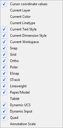

  1. Coordinates field
  2. Drawing properties
  3. Drawing aids
  4. Status bar option button.
    Displays a list: Click an option to toggle the corresponding field on/off.
