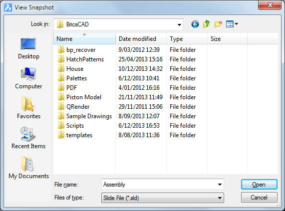

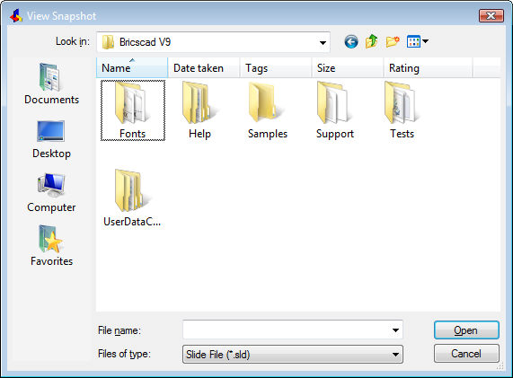

Choose a file, and then click Open.
To remove the slide from the viewport, use the Redraw command.
File name
Specifies the name of the slide file.
Files of type
Selects the file type of the slide file:
  • Slide File (*.sld) is the proprietary graphics format used by AutoCAD for slides.
  • Enhanced Metafile (*.emf) is the enhanced WMF format.
  • Windows Metafile (*.wmf) is the hybrid raster-vector format developed by Microsoft.
Open
Displays the slide in the current viewport. Use the Redraw command to remove the slide.
