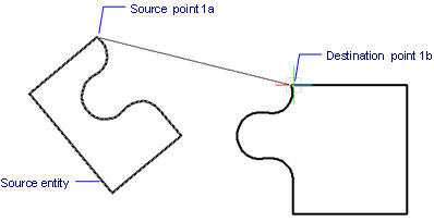

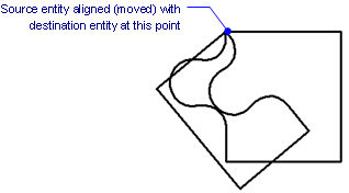

To move entities, specify one pair of source and destination points to move entities:
Specifies the source alignment point, such as #1a in the figure above. |
Specifies the destination alignment point, such as #1b in the figure. |

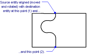

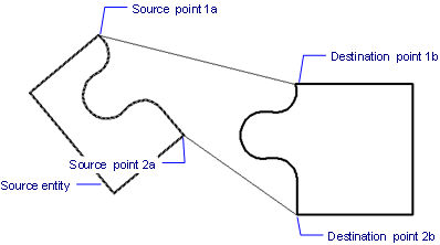

To move and rotate entities, specify a second pair of source and destination points to move and rotate entities:
Specifies the second source alignment point, such as #2a in the figure above. If you press Enter at this prompt, the source object moves. |
Specifies the matching destination point, such as #2b in the figure. |
To move and rotate 3D entities, specify a third pair of source and destination points to move and rotate 3D entities.
Specifies the source point for 3D alignment; press Enter to move and rotate 2D entities. |
Specifies the matching destination point. |
