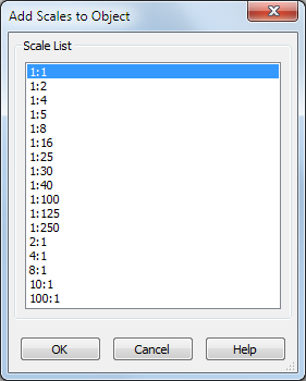

Adds annotation scales to the selected annotative entities. Displays a dialog box:
Select one or more scales in the list, then press the OK button to add the selected scales. Press and hold the Ctrl key to:
To select a series of scales: select the first scale, then press and hold the Shift key and select the last scale.
