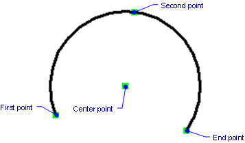

Center/<Start of arc>: (Pick a point, enter coordinates, or enter an option.)
Angle/Center/Direction/End/Radius/<Second point>: (Pick a point, enter coordinates, or enter an option.)
End point: (Pick a point or enter coordinates.)

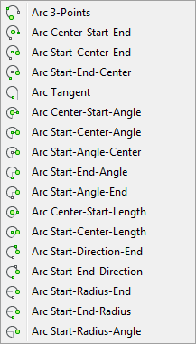

This command draws arcs by 17 methods. You can see the full list in the Draw | Arc menu:
