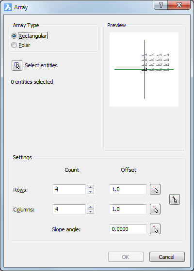

Rectangular array dialog box

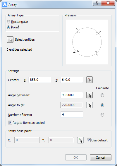

Polar array dialog box
 Rectangular Array command options
Click the Select button () .
The Array dialog box temporarily closes.
You are prompted to select entities.
Rows Count
Specify the number of rows.
Rows Offset
Specify the offset between subsequent rows.
A positive offset adds rows from left to right.
Do one of the following:
  • Type a distance in the Rows Offset field.
  • Click the Pick Points button ().
    Prompts you: Vertical distance between rows:
    Specify two points in the drawing.
Columns Count
Specify the number of columns.
Columns Offset
Specify the offset between subsequent columns.
A positive offset adds columns from bottom to top.
  • Type a distance in the Columns Offset field.
    Prompts you: Horizontal distance between columns:
Spacing Rectangle
Specify a rectangle.
Rectangle length = Columns offset.
Rectangle width = Rows offset.
Prompts you: Specify spacing rectangle:
Slope Angle
Specify a rotation angle for the spacing rectangle.
The angle is calculated with respect to the current coordinate system.
  • Type an angle in the Slope angle field.
    Prompts you: Select angle of array:
Polar Array command options
Center
Specifies the center point of the array.
  • Enter coordinates in the X and Y fields.
  • Click the Pick Point button ().
    Prompts you: Base/Center of polar array:
    Specify a point in the drawing.
Angle between
Specifies the angle between each copy.
  • Click the Calculate radio button to calculate the angle from the Angle to fill and Number of items.
  • Type an angle in the Angle field.
    Prompts you: Specify angle between:
    A line displays dynamically from the current Center point.
Angle to fill
Determines the extent and direction of the array.
Enter 360 for a full circle of copies; enter a smaller number to draw a partial polar array.
Enter a positive angle to draw the array counter clockwise; enter a negative number to draw the array clockwise.
  • Click the Calculate radio button to calculate the angle from Angle between and Number of items.
Number of items
Specifies the number of items in the array
  • Click the Calculate radio button to calculate the angle from the Angle between and Angle to fill.
  • Enter a number larger than 1.
Rotate items as copied
Determines whether copies are rotated when they are arrayed:
  • No does not rotate entities; all copies have the same orientation as the original.
  • Yes rotates copies.
Entity base point
Relocates the base point of the selected entities.
  • Check the Use Default option (= lower left corner of the selection set bounding box).
