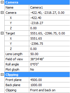

Editing a Camera
Properties of a camera view can be edited:

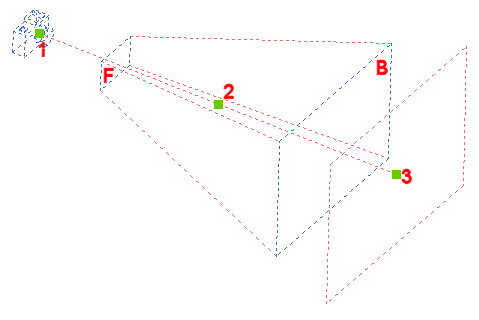

Grips Editing
Cameras can be edited directly through grips:
