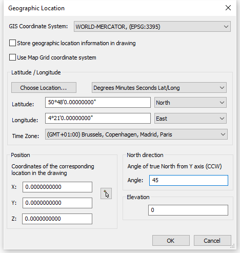

Sets the geographic location of the drawing.
command bar: geographiclocation
alias: geo
toolbar: Render | ![]()
Settings
Setting |
GIS Coordinate System |
Choose a coordinate system from the list. |
Store geographic location information in the drawing |
If checked, a red dot indicates the position of the selected location in the drawing.
Use Map Grid coordinate system |

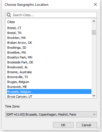

Choose Location |
Displays the Choose Geographic Location dialog box.
Latitude |
Sets the latitude of the drawing in either Degrees/Min./Sec. or decimal format. The valid range is 0 to 90. Choose North or South from the latitude option button. The value is saved to the LATITUDE system variable. |
Longitude |
Sets the longitude of the drawingin either Degrees/Min./Sec. or decimal format. The valid range is 0 to 180. Choose East or West from the longitude option button. The value is saved to the LONGITUDE system variable. |
Timezone |
Choose a time zone from the Time Zone drop down list. The setting is saved to the TIMEZONE system variable. |
Position |
Defines the position of the selected location in the drawing. Either type the coordinates in the X-, Y- and
Z-fields or click the Pick Point
button ( Optionally, type a value in the Elevation field. |
North Direction Angle |
Specifies the angle of the sun from north, in the context of the world coordinate system. The setting is saved to the NORTHDIRECTION system variable. |
