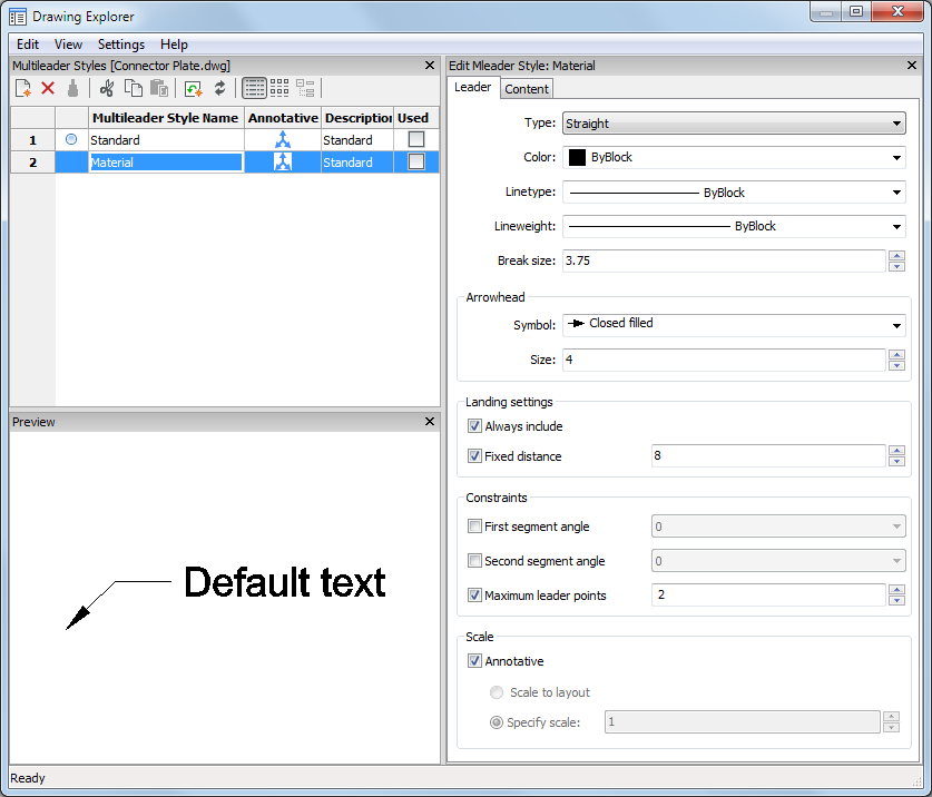

Creates and manages multileader styles through the Drawing Explorer.
command bar: mleaderstyle
menu bar: Tools | Drawing Explorer | Multileader Styles...

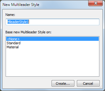

: mleaderstyle
Creates a new multileader style. Displays a dialog box:
Deletes the selected multileader style. You cannot delete the Standard style or a style that is used in the drawing. |
Leader Properties |
Type |
The leader type can be either Straight, Spline or None. |
Color |
Sets the leader and arrowhead color. |
Linetype |
Sets the leader linetype |
Lineweight |
Sets the leader lineweight. |
Break Size |
Sets the break size used for the DIMBREAK command when the
multileader is selected. |
Arrowhead |
Determines the appearance of the leader arrowhead:
Landing Settings |
Controls the creation and size of the leader landing:
Constraints |
Defines the constraints of the mleader entity.
Scale |
Controls the scaling of the multileader entity.

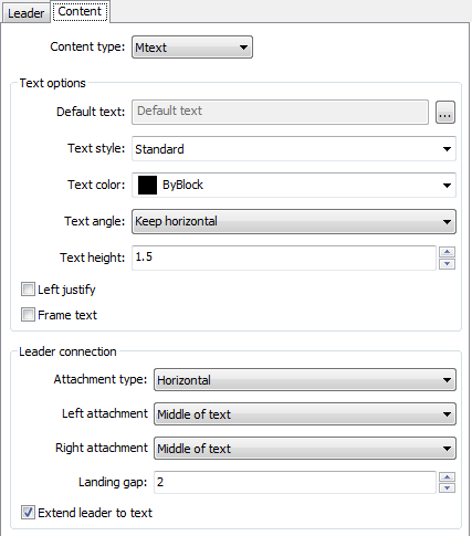

Content |
Content type |
Sets the content type of the mleader entity.
Mtext |
Text options |
Determines the appearance of the Mtext:
Leader connection |
Specifies how the leader and the Mtext are connected.

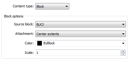

Block |
Source block: |
Specifies the block to be used. |
Attachment: |
Sets the attachment of the block to the leader. The options are:
Color: |
Specifies te color of the block, if the entity color of the entities in the block is set to ByBlock. |
Scale: |
Sets the scaling of the source block. |
