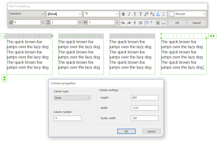

Displays a Text Formatting toolbar and text entry field:
Enter text, and then click OK.
Specifies the style.
Choose a style name from the droplist. See Style command.
Font
Specifies the font.
Choose a font name from the droplist; this overrides the font specified by the style. BricsCAD can use any font installed on your computer.
To apply a font to just one or two words, highlight them, and then choose the font from the droplist,
as illustrated below:

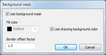

Background Mask
Sets the background mask.

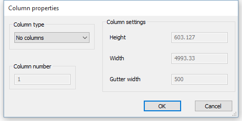

Columns
To divide the text in columns:
Right click and choose Columns... in the context menu.
The Column Properties dialog box displays:
  • Column type: defines how the number of columns is controlled.
  • Column number: number of columns
  • Height: maximum height of the columns.
  • Width: width of each column.
  • Gutter width: space between the columns.
Click the Column type list button and select a column type in the list:

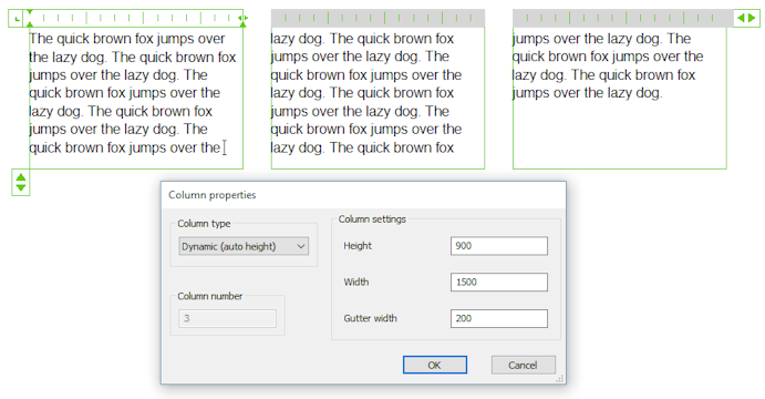

  • Dynamic (auto height):
    Type a value in the Height, Width and Gutter width fields. The number of columns is calculated automatically
    Optionally, adjust the column height by dragging the control button.

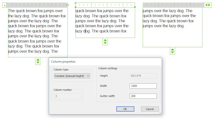

  • Dynamic (manual height):
    Type a value in the Width and Gutter width fields. The number of columns is calculated automatically.
    The Height can be controlled by dragging the control button for each column separately.
  • Static:
    Type a value in the Column number, Height, Width and Gutter width fields.

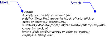

Grips Editing
Mtext bounding boxes can be edited directly through grips:
  1. Select the mtext. Notice that it has two grips.
