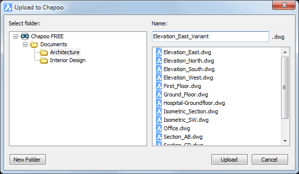

Uploads the current drawing to Chapoo.
command bar: chapooupload
menu bar: File | Chapoo | Upload...
toolbar: Chapoo | ![]()
: chapooupload
If you are not yet logged on to Chapoo, the ChapooLogon command is launched first.
New Folder |
Creates a new folder as a subfolder of the currently selected folder. |
Upload |

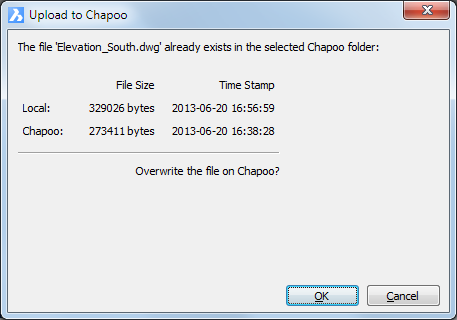

Uploads the drawing to the selected folder. If a drawing of the same name already exists in the selected folder, the drawing is uploaded as a revision of the original drawing. A dialog displays:
