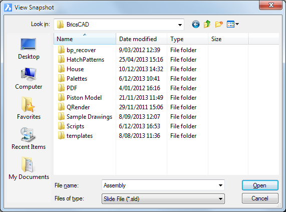

Choose a file, and then click Open.
To remove the slide from the viewport, use the Redraw command.
File name |
Specifies the name of the slide file. |
Files of type |
Selects the file type of the slide file:
Open |
Displays the slide in the current viewport. Use the Redraw command to remove the slide. |
