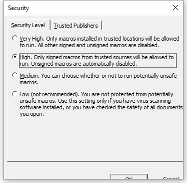

Depending on the selected security level (Low, Medium or High) VBA macros are allowed to run automatically or not.
command bar:  vbasecurity
menu bar:  Tools | VBA | Security
: security
Choose a level of security, and then click OK.
This dialog box is necessary, because Microsoft's design of VBA applications allows use of destructive code, which can damage files on your computer.
VBA is short for Visual Basic for Applications; it is a programming language found in many Windows applications.
Very High
Only VBA macros installed in trusted locations will be allowed to run. All other signed or unsigned macros are disabled.
High
Only signed macros from strusted sources will be allowed to run. Unsigned macros are automatically disabled.
Medium
BricsCAD displays a dialog box when a VBA macro runs.
The dialog box allows you to choose whether or not to run the macro.
Low
All VBA macros are run.

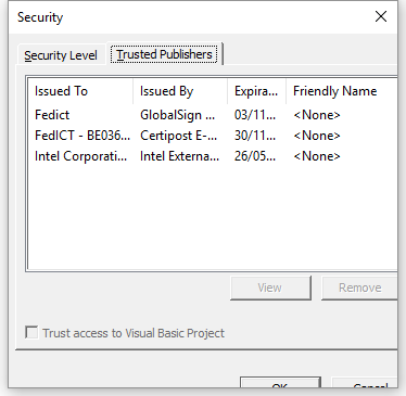

Trusted Sources Option
Trusted Sources
Lists the names of VBA macros that can be trusted. These are the only macros that will run when security is set to High.
Remove
Removes the selected VBA macro from the list.
Trust access to Visual Basic Project
Allows access to the VBA Project.
