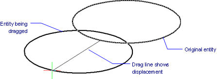

Controls the appearance of objects while being dragged.

This command was useful in the early days of CAD when computers were slow and had difficulty updating the screen quickly enough to show objects being dragged. This command is no longer necessary, and has been kept only for compatibility.
ON
Turns on dragmode; same as Auto mode.
OFF
Turns off dragmode; dragged objects and the dragline are never shown on the screen.
Auto
Turns on drag mode; dragged objects are always shown.
