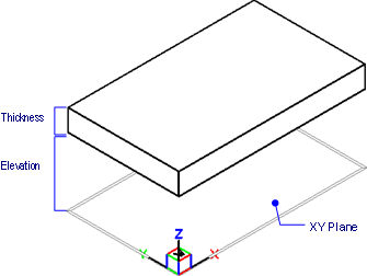

New current elevation
Specifies the elevation; enter a negative value for a negative elevation.
The elevation is reported on the status bar as the z coordinate.
The elevation is the height of the xy plane in the z direction.
New current thickness
Specifies the thickness; the thickness begins at the elevation; enter negative values for thicknesses that are drawn downwards (negative z direction).
The thickness is the extrusion distance (in the z direction) of non-3D entities, such as points and circles.
When thickness is not 0:
  • Points become lines.
  • Lines become planes
  • Arcs become curved surfaces.
  • Circles and donuts become cylinders.
  • Rectangles and polygons become prisms.
