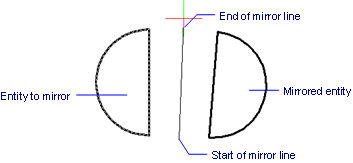

Start of mirror line: (Pick a point, or enter x,y coordinates.)
End of mirror line: (Pick another point.)
Delete the original entities? <N> (Type Y or N.)
Select entities to mirror
Chooses one or more entities to mirror.
Specifies the start point for the line about which entities are mirrored.
This line is temporary; as soon as you pick the second point, it disappears.

End of mirror line
Specifies the second point of the mirror line.
