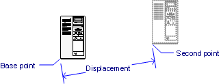

Enter base point: <Displacement> (Pick a point, enter x,y coordinates, or type D.)
Enter second point: <ENTER to use base point as displacement> (Pick another point, or press Enter.)
Specifies the entities to be moved. |
Specifies the starting point. Pick a point in the drawing, or enter x,y coordinates. Use entity snap modes to ensure accuracy. To move entities horizontally or vertically, hold down the Shift key. |
Specifies the destination for the entities. Pick a point in the drawing, or enter x,y coordinates. |
Specifies the distance to move the entities; prompts you: Enter displacement point - pick a point. |
Enter displacement point |
Enter x,y,z coordinates to specify the distance in the x, y, and z direction. To move 10 units only in the x direction, enter 10,0. |
When using the base point as displacement, Bricscad measures the distance from the origin (0,0,0) to the x,y,z coordinates of the base point. Caution: this option can move entities farther than you may expect. |
