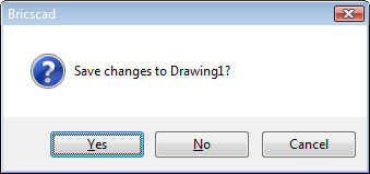

If drawings are unsaved, displays a dialog box:
Saves the drawing, and then exits Bricscad. |
Does not save the drawing, and then exits Bricscad. |
Cancels the command; Bricscad does not exit. |
