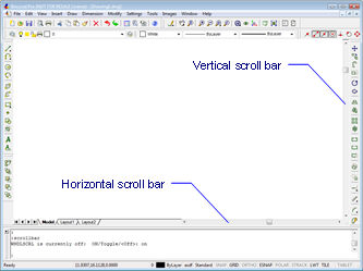

WNDLSCRL is currently on: OFF/Toggle/<On>: (Enter an option.)
Scroll bars are useful for panning the drawing without using the Pan command:
The only reason to turn off scroll bars is to gain a bit more drawing area.
