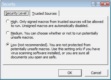

Choose a level of security, and then click OK.
This dialog box is necessary, because Microsoft's design of VBA applications allows use of destructive code, which can damage files on your computer.
VBA is short for Visual Basic for Applications; it is a programming language found in many Windows applications.
High
Only VBA macros listed as "trusted sources" will be run.
Click the Trusted Sources tab to specify the names of trustworthy VBA macros.
Medium
Bricscad displays a dialog box when a VBA macro runs.
The dialog box allows you to choose whether or not to run the macro.
Low
All VBA macros are run.

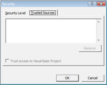

Trusted Sources Option
Trusted Sources
Lists the names of VBA macros that can be trusted. These are the only macros that will run when security is set to High.
Remove
Removes the selected VBA macro from the list.
Trust access to Visual Basic Project
Allows access to the VBA Project.
VbaLoad loads VBA projects.
