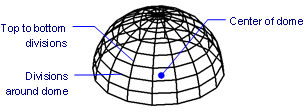

Draws the upper half of a sphere as a 3D mesh surface.
command bar: ai_dome
menu bar: Model | Meshes | Dome
toolbar: Meshes |
: ai_dome
Center of dome: (Pick a point or enter coordinates.)
Diameter/<Radius of dome>: (Pick a point, enter coordinates, or enter R.)
Number of divisions around dome <16>: (Enter a number, or press Enter to keep the default value.)
Number of top-to-bottom divisions <8>: (Enter a number, or press Enter to keep the default value.)
Specifies the center point of the dome's open end; the end is drawn on the current x,y-plane. |
Specifies the radius of the dome. |
Changes the number of horizontal isolines used to simulate the dome's curved surface. |
Changes the number of vertical isolines from the default of 8. |
Specifies the diameter of the dome. Prompts you: Diameter of dome - specify the diameter by pointing or entering a value. |
