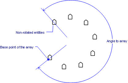

Polar
Creates polar (circular) arrays. Prompts you:
Type of array:  Rectangular/<Polar>: (Type P.)
Base/Center of polar array: (Pick a point, or type B.)
ENTER to specify angle between items/<Number of items to array>: (Enter a number, or press Enter.)
Angle to array (+ for ccw, - for cw) <360>: (Enter a positive or negative angle.)
Rotate entities around the array?  No/<Yes>: (Type N or Y.)

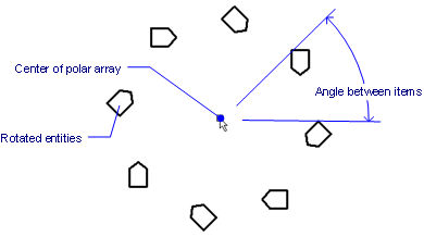

Polar arrays can have rotated or non-rotated entities:
Polar Array Options
Base
Relocates the base point of the selected entities.
Specifies the center point; enter coordinates or pick a point.
Specifies the angle between each copy.
Specifies the number of items in the array; enter a number larger than 1
Angle to array
Determines the extent and direction of the array. Enter 360 for a full circle of copies; enter a smaller number to draw a partial polar array. Enter a positive angle to draw the array counter clockwise; enter a negative number to draw the array clockwise.
Determines whether copies are rotated when they are arrayed:
  • No does not rotate entities; all copies look the same as the original.
  • Yes rotates copies.
