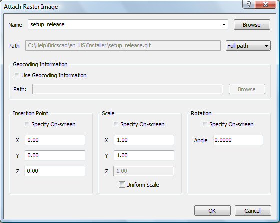

Options |
Specifies the file name of the image. |
Displays the Open dialog box; click this button to choose a different raster file.
Choose a raster file, and then click Open. |
Path |
Reports the path to the image file; cannot be edited by the user. |
Determines how much of the path is stored:
c:\foldername\imagename.ext
..\foldername\imagename.ext where .. refers to the folder above the current one.
Geocoding Information |
Position files or world files have an extension that depends on what kind of image file they are associated with. See explanatory notes below: "About Geocoding Information". |
Toggles use of a position file, which specifies the size, location, and rotation of the image file:
Reports the path to the position file. |
Displays the Select Image Position File dialog box; choose a TWF file, and then click Open. |
Positions the lower left corner of the image in the drawing. This option is unavailable when a position file is used. |
Toggles where you specify the insertion coordinates:
Insertion point - specify the x,y or x,y,z coordinates of the image's lower left corner. |
Specifies the x coordinate of the image's lower left corner. |
Specifies the y coordinate of the image's lower left corner. |
Specifies the z coordinate of the image's lower left corner. |
Sizes the image. This option is unavailable when a position file is used. |
Toggles where you specify the scale factors:
Scale factor - specify the scale factor. |
Specifies the scale factor in the x direction:
Specifies the scale factor in the y direction |
Specifies the scale factor in the z direction. |
Makes the Y and Z scale factors equal to X. |
Rotates the image about the insertion point. |
Toggles where you specify the rotation angle:
Rotation angle - specify the angle. |
Specifies the rotation angle about the insertion point.
