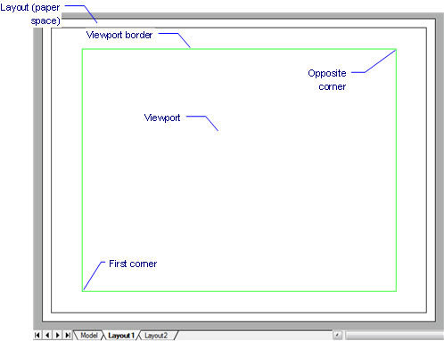

Viewports: ON/OFF/Lock/Fit/2/3/4/Object/Polygonal <First corner>: (Pick a point, or enter an option.)
Opposite corner: (Pick another point.)
The viewport allows layouts to display entities drawn in model tab.
Specifies one corner for a new, rectangular viewport. Pick a point, or enter x,y coordinates. |
Specifies the other corner for a new viewport. |

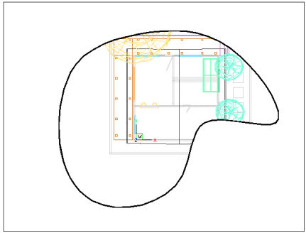

Converts an object into a viewport border; prompts you: Select an object to clip viewport - specifies a closed object. The viewport is traced over the object; the original object remains in the drawing. This option is useful for ensuring a viewport border precisely matches an outline.
Draws non-rectangular viewports made of lines and arcs; prompts you: Specify start point - specifies the starting point for the polygon. Arc/Distance/Follow/<Next point> - specify a point, or enter an option. Arc/Distance/Follow/Undo/<Next point> - specify a point, or enter an option. Arc/Close/Distance/Follow/Undo/<Next point> - specify a point, or enter an option. Enter C to close the polygon and exit the command. |
