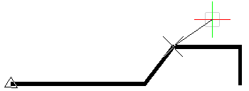

Break
Removes segments from the polyline; prompts you:
Next/Previous/Select/Go/eXit/<Next> - enter an option.
Bricscad marks the two vertices that define the segments to be removed with two X markers.
Next
Moves the second X marker to the next vertex.
Previous
Moves the second X marker to the previous vertex.
Select
Moves second X marker directly to another vertex; prompts you:
Select point along segment move to - pick a point on the polyline.
Bricscad places the second X marker on the vertex nearest to the pick point.
This option is faster than using Next and Previous.
Go
Erases the segments between two marked vertices.
This action turns:
  • Closed polylines into open polylines.
  • Open polylines into two polylines, with a gap between them.
This action cannot be undone.

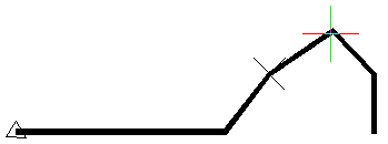

Insert
Inserts a vertex; prompts you:
Location of vertex - pick a point for the new vertex.
The drag line previews the location of the new vertex.
Bricscad adds the vertex and segment.

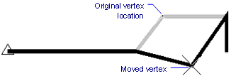

Move
Moves the current vertex; prompts you:
New location for vertex - pick point to move the vertex.
The drag line previews the new location of the vertex.
Bricscad moves the vertex and associated segments.

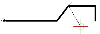

Removes all segments between two vertices; prompts you:
Straighten: Next/Previous/Select/Go/eXit - enter an option
When you select the start and end points of an multi-segment polyline, the entire polyline is straightened, becoming a single segment; this also applies to closed polylines.
Next
Previous
Select
This option is faster than using the Next and Previous options.
Go
Replaces the segments between the two marked vertices with a single segment.
