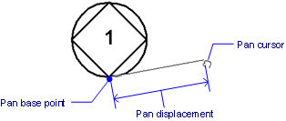

Left/Right/Up/Down/PGLeft/PGRight/PGUp/PGDown/<Pan base point>: (Pick a point, or enter an option.)
Pan displacement point: (Pick another point.)
Pan base point
Specifies the pan distance's starting point.
Specifies the ending point.
