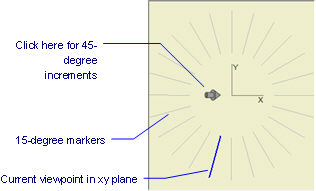

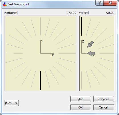

Dialog Box Options
Horizontal
Vertical
Angle Precision
Sets markers at 5, 15, or 45 degrees; default = 45.
Plan
Reverts from the 3D viewpoint to 2D plan view.
Previous
Reverts to the previous viewpoint.
Set
Sets the viewpoint and exits the dialog box.
