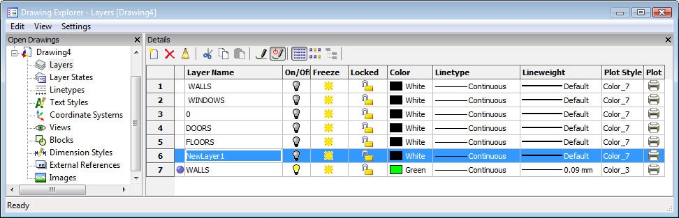

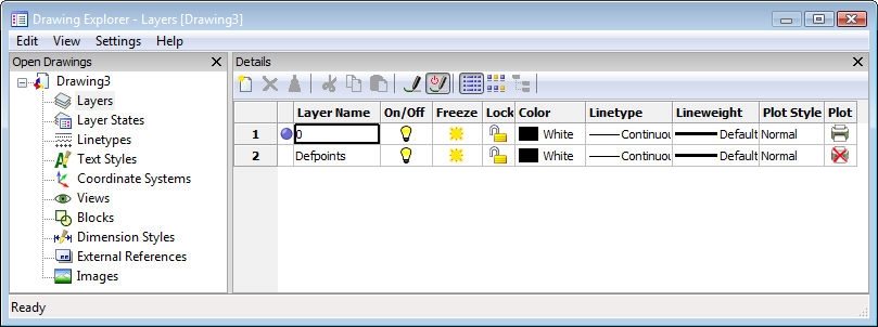

Displays the Layers section of the Drawing Explorer dialog box:
Create layers or modify layer properties, and then click X.

Layer Name
Specifies the name of the layer. To rename:
  1. Click the name twice, slowly.
  2. Enter the new layer name.
On/Off
Toggles the selected layers between on and off:
On - sets the normal state.
Off - hides entities from view; entities are included in the calculation of extents.
Click a lightbulb icon to change its status.

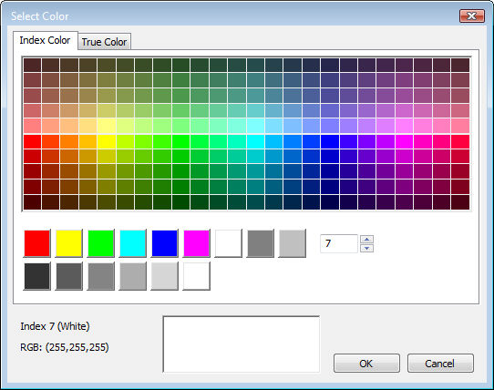

Color
Specifies the color of the layer. Default color is white (black).
To change the color:
1. Click a color square to see the Select Color dialog box.
2. Choose a color, and then click OK.
See Color command.
