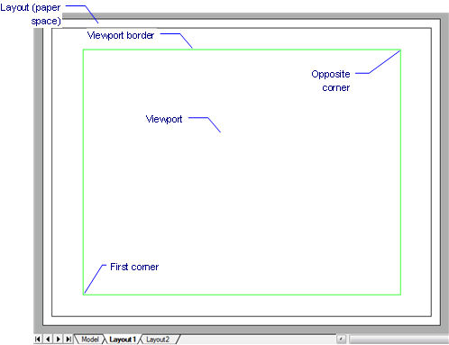

Viewports: ON/OFF/Lock/Fit/2/3/4/Object/Polygonal <First corner>: (Pick a point, or enter an option.)
Opposite corner: (Pick another point.)
The viewport allows layouts to display entities drawn in model tab.
First corner
Specifies one corner for a new, rectangular viewport.
Pick a point, or enter x,y coordinates.
Opposite corner
Specifies the other corner for a new viewport.

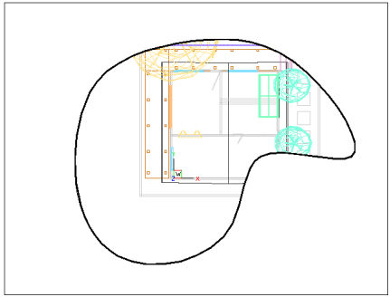

Polygonal
Draws non-rectangular viewports made of lines and arcs; prompts you:
Specify start point - specifies the starting point for the polygon.
Arc/Distance/Follow/<Next point> - specify a point, or enter an option.
Arc/Distance/Follow/Undo/<Next point> - specify a point, or enter an option.
Arc/Close/Distance/Follow/Undo/<Next point> - specify a point, or enter an option.
Enter C to close the polygon and exit the command.
