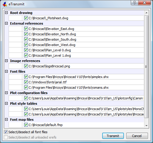

A dialog box displays:
Select the files to be included in the eTransmit package, then click the Transmit button.
