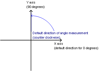

Angle 0 direction
Specifies the direction for 0 degrees.
Enter an angle, or pick two points in the drawing.
The default is the positive x axis.
You can also rotate the drawing through the Snap command's Rotate option.
Do you want angles measured clockwise?
Specifies the direction in which to measure angles:
  • Yes - measures angles clockwise.
  • No - measures angles counterclockwise (default).
