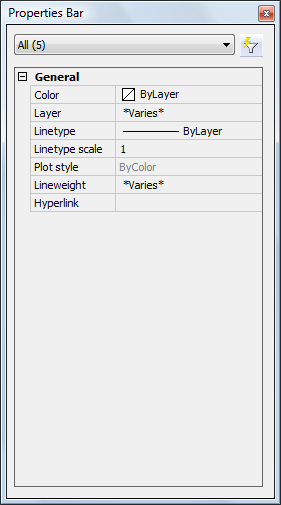

Properties Bar - Multiple entities (5) selected
The shared properties of the selected entities display

Edit the shared properties of a selection set
  1. Select the entities.
    The shared properties display in the Properties Bar.
  2. Click the property you want to modify.
    The settings field of the selected property is activated.
  3. Type  a new value in settings field of the selected property or choose a setting from the list box, then press the Enter key or select another property.
    All selected entities are updated simultaneously.
  4. (option) Repeat steps 2 and 3 to modify another property.
  5. Press the Escape key  to stop.
NOTES
  • *Varies* displays for shared properties which are defined differently. If you edit such property, all entities in the selection set will be equally defined for this property.
  • Step 3: Properties (such as the General properties), which are chosen from a list are updated instantly.
