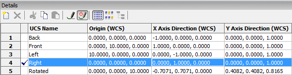

To define a User Coordinate System
Choose Coordinate
Systems in the Settings
menu.
The Bricscad Explorer - Coordinate
Systems dialog opens.
Click the New tool
button (
) on the Bricscad Explorer dialog.
The Bricscad Explorer dialog
closes.
The command bar reads:
Current/Entity/Origin/View/X/Y/Z/ZAxis<3point>:
A prompt menu displays:
Press Enter to define the UCS using points.
The command bar reads: New origin <current origin>:
Specify the origin point of the UCS.
The command bar reads: Point of positive X axis <current
point>:
Specify a point to define the positive X-axis.
The command window reads: Point in X-Y plane with positive Y value
<current point>:
Specify a point to define the positive Y-axis.
The UCS is defined.
reopens.
Click in the UCS Name field of the newly defined UCS to replace the <NewUCS> default name.
Close the Bricscad Explorer dialog.
See the EXPUCS and UCS commands.

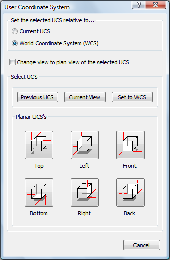

Do one of the following:
Click the UCS... tool button (
) on the Settings toolbar.
Choose UCS... in the Settings menu.
The User Coordinate System dialog opens.
Choose one of the following:
Set the selected UCS relative to the Current UCS.
Set the selected UCS relative to the World coordinate system (WCS).
(option) Enable the Change view to plan view of the selected UCS option.
Click one of the Planar
UCS's buttons.
The User Coordinate System dialog closes.
See the SETUCS command.
